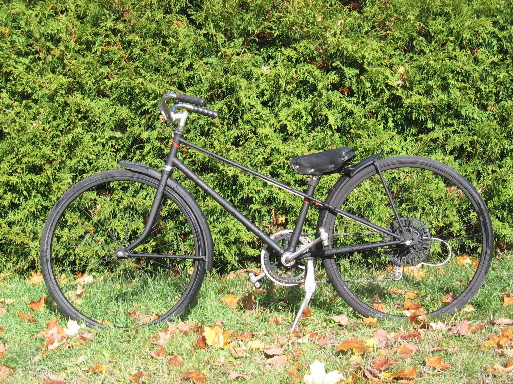

Hey all, so this is my first project thread anywhere, ever. I've done many things but rarely photo-document them...
Anywho, this is a continuing work in progress but this is what I've got so far:
Started out with a stock, women's CCM bike of unknown age that we found in the basement of my brother's new house.
The bike was in awesome shape aside from the dirt and grime, plus it was free. Even the tires and tubes are in awesome shape...
Started with just a simple chop, gave it a better stance over all. Took about 6" out of the seat post and hacked the back fender.
Stripped all the extras off it, only left the gear selector so I could keep the rear derailleur in check. That will be getting shaved as well.
I wasn't too crazy about the way the rear fender was sitting, especially with my janky little bracket, but it was mostly just to see what the bike would look like.
Scrubbed a bitch down, and debated keeping the factory brown. It did look kinda cool, but not my bag.
before:
after:
Stripped the whole thing down for paint and sanded it.
While I had it apart I decided to modify the rear fender, for a more secure mounting, and so it didn't look like dog poop.
Didn't take as many pics of this as I probably should have for a proper project thread but oh well.. You get the gist of what was done.
Sprayed the whole thing flat black with some leftover rattle cans I had (will get a proper paint job this winter)
Rims too
Did some small pinstriping work for a bit of accent. (wanted to do a red line around each rim but I didn't have any red paint and not enough red pinstripe)
And here she sits so far.
Definitely way more comfortable to ride than it might look.
To come:
"Ape hanger" handle bars
Re-lacing both rims with some type of radial high spoke count design
Ditch rear gearset and make it a fixed ratio.
Proper paint job (still flat black, and will do pinstriping that I actually want)
Contemplating whether to make it a fixie or put a coaster brake in the rear hub (currently no brakes, it's a cruiser, so I don't get going faster than I can stop with putting my feet down...)
Any suggestions on links for lacing spokes would be great, I flexed my Google-fu a bit and only found a few designs, but I'd like more info...
I wasn't sure if this should go in mini-fab, or cycle fab, but since this is a bicycle, and this is cycle fab, it goes here

Yay freak bikes!
If you plan ride that bike for any more then a couple of blocks will probably want to moved the bottom bracket forward to get decent leg extension; number one thing that makes choppers no fun to ride is a bad layout for proper leg extension.
Couple of things:
Do not radial lace the rear, they don't like it unless you go super high spoke count and use motorcycle spokes. Also, it will be hard to find a decent rim in that size for more then 40 hole counts and you are not going to find a hub, track, cassette or otherwise over 36 hole unless you go with an old Sturmey Archer 3 speed. Stick to a 2 or 3 cross rear or you are going to have reliability issues, and if you want a freaky looking front go with a twisted spoke design, have fun truing it...
You can make the bike a single speed now by just using one of the cogs on the free wheel, shortening the chain and ditching the derailure; it's ghetto as **** but it gets rid of the extra parts. Removing the gears in the back makes the bike a single speed, not a fixed gear. Fixed gear means there is no freewheel, this means when the wheels move so do the pedals; like a track bike. Fun to ride but sucks for choppers or talls.
If you want a nice clean look get a coaster brake but I would recommend finding an old one as all the newer ones suck compared to the old ones. Whatever you do I urge you to not run without brakes, at all, period it is a good way to get killed. Personally I never ride a bike with only one way to stop it; my coaster brake bike still has a front caliper brake as does my fixed gear and they both stil are pretty clean looking bikes. The green one is a hand built frame as well.
If you are interested in freak bikes and what people build check out Chicago Freak Bike and The Rat Patrol.
Atomic Zombie has some pretty cool stuff to but his work is a little to fancy for my garbage picking freak bike tastes.

I know the difference between a fixie and a single-speed, I'm just deliberating which way to go. I think I'm gonna go with a coaster brake just 'cause I don't want to have any hardware on the bike at all, and I do want to have a brake.
Seating/riding position isn't too bad actually, and the seat is gonna get moved back over the fender a touch more, which should allow me a bit more room. I'm strongly considering kicking the pedals out an inch or so though.
I'm considering a twisted spoke set up like this: http://www.instructables.com/id/Custom_twist_bikewheel/
If you don't think that'll be strong enough for the rear, I'm thinking 4 cross or crows foot. Both look pretty cool IMO.
I ditched the shift lever, and fixed the derailleur in place with a piece of cable holding it in that position. Might ditch it and shorten the chain, but we'll see.
