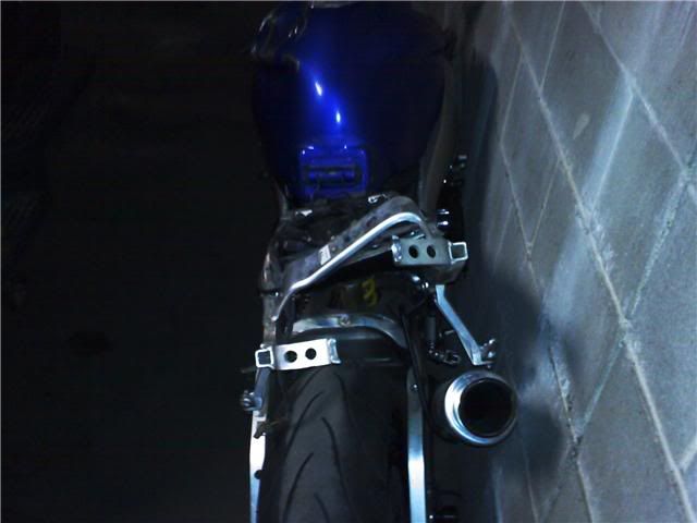

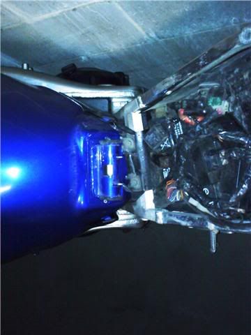

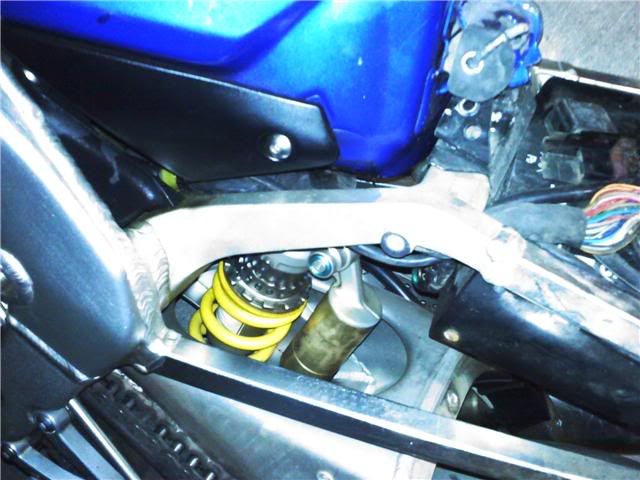

Not sure If I'm doing this right.
<a href="http://s828.photobucket.com/albums/zz203/Zim6/?action=view&current=BIKESUBFRAME4.jpg" target="_blank"><img src="http://i828.photobucket.com/albums/zz203/Zim6/BIKESUBFRAME4.jpg" border="0" alt="Photobucket"></a>
This is the bar that is bent on each side. Everything welded on behind this will be replaced.
<a href="http://s828.photobucket.com/albums/zz203/Zim6/?action=view&current=BIKESUBFRAME2.jpg" target="_blank"><img src="http://i828.photobucket.com/albums/zz203/Zim6/BIKESUBFRAME2.jpg" border="0" alt="Photobucket"></a>
<a href="http://s828.photobucket.com/albums/zz203/Zim6/?action=view&current=BIKESUBFRAME3.jpg" target="_blank"><img src="http://i828.photobucket.com/albums/zz203/Zim6/BIKESUBFRAME3.jpg" border="0" alt="Photobucket"></a>

I could be 100% wrong.
Be safe find a frame...

You dont think it would be wise to cut it off at the weld in front of the shock in the first picture?

It's your life & checkbook.
do you trust your abilities or is someone else gonna do the welding?
I would check the steering neck & the rest of the frame before I put much time in it. there may be more damage than you are noticing since you are concentrating on the rear. secondary damage can go unnoticed easily.
aluminum is not a very forgiving material, I would look for a frame.

I'm going to Tig it. Found a subframe online so I won't have to bed anything. Plan on adding a few gussets and boxing in the sub for some extra support for the 12 o'clock bar. Thanks for all the replys guys.

That look like a bad bend. I would definitely look close at that frame.
On a another note a local stunter here cracked his frame by the steering neck on his GSXR 750 about 3 years ago in an accident as well as mangling the subframe. He had a local machinist weld the frame and it has been fine and it gets abused as it is a full time stunt bike. But a stunt bike is different then something that is going to see alot of street duty or a road course .
