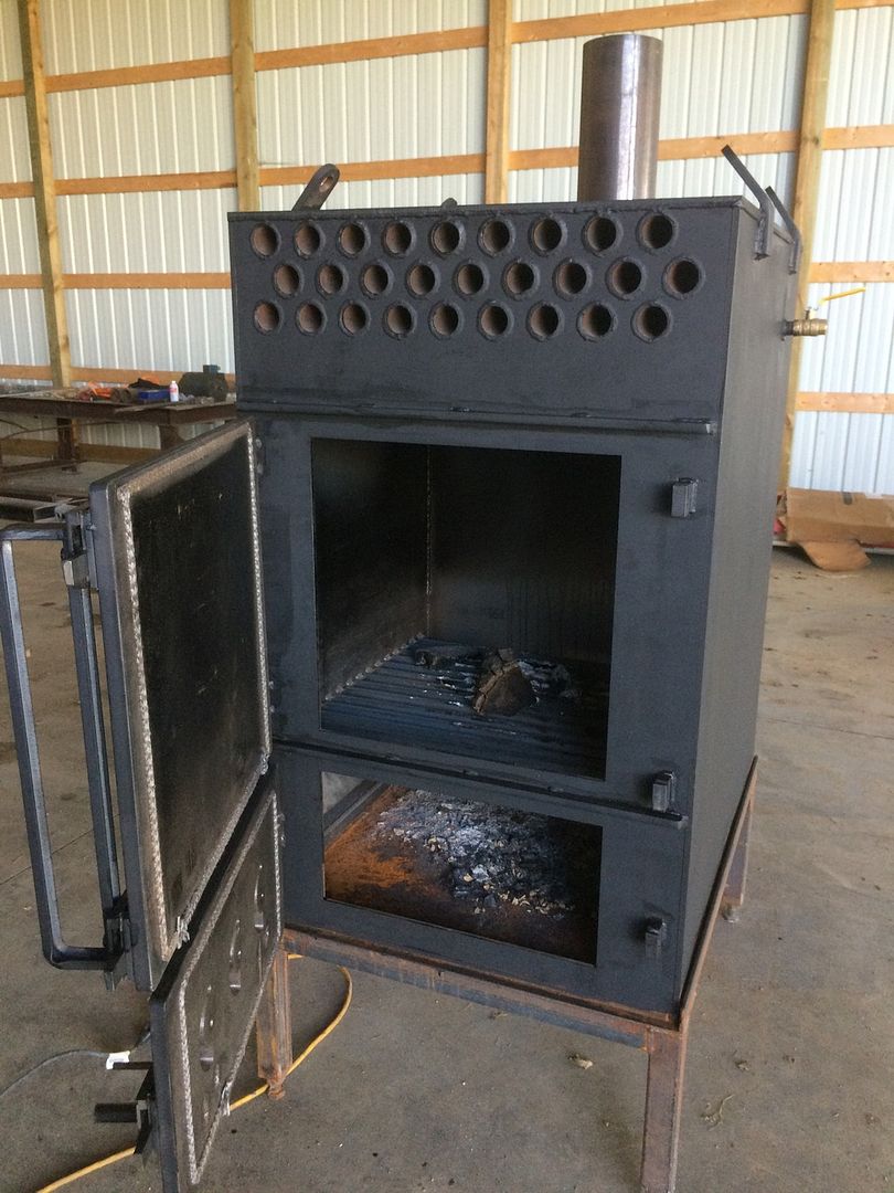

I built a wood stove for my shop. This is going to be the third year for it. My shop is 5000 sq feet and 20 foot to the bottom of the truss. It takes 2 hours to get fro 30 to 60 degrees.
I will post pic pictures when I figure it out
